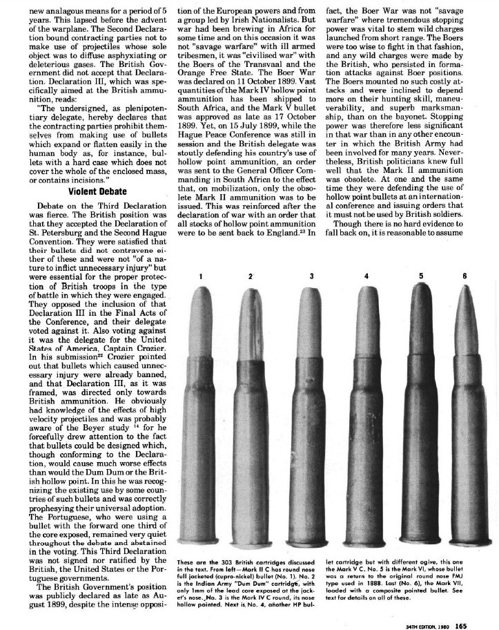

Posts: 7790
Re: 303 ENFIELD, DUM DUM METAK, HASKA KONVENCIJA
