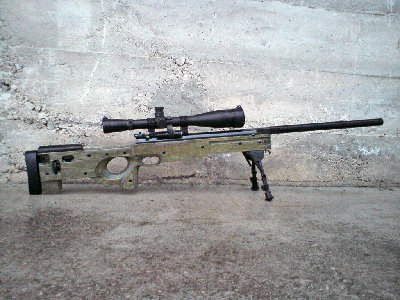

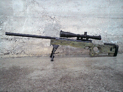

Novi "setup"
Weihrauch HW80 4,5mm
Custom stock W/ adjustable butt stock & cheek
Vector Raptor 6-24x50 (glass etched reticle) + honeycomb sunshade +butler creek flip up covers @ modified 1 piece mount
Vector Laser - red
B-Square bubble level +Gamo scope stop creep
Lightweight 25mm barrel shroud
Hong-Kong harris style bipod =)
Cekam bolje vrijeme da upucam opiku do kraja

Joooj mrcine!! Koliko to sad teži?? Gdje je laser??
Re: Weihrauch HW80 - upgrade
Tezina je 5,5kg+, vaga vaze max 5kg +ono sto moze preko, e sad neznam jeli sa tih 5,5 stigla do kraja krajeva ili moze jos dakle 5,5kg ili teža!
Laser potrazi na prvoj slici na mjestu "zatvaraca" =)

Cijev zašarafljena na paket parketa! :A19:
